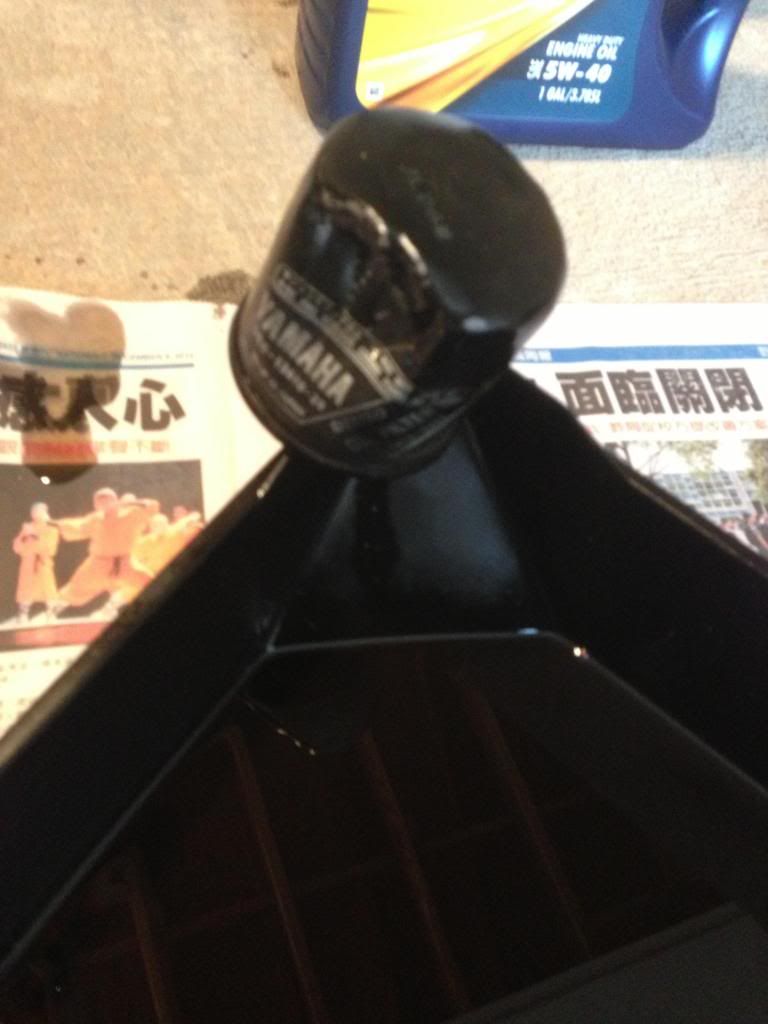

Originally Posted by ibspoolin86 View Post
Word of advice. Just remove your mid and lower fairings then proceed to unbolt the shifter bolt.that should take you at least a couple minutes now not acouple hrs
Now I know lol.. I removed all of the left side fairings ...
thats why took me longer...
Now I kinda know where everything is and what screws to remove for what..
second oil change will be a snappy for sure.
finished up the job this morning... used a pair of pipe wrench as a member said earlier to remove the oil filter... I totally mangled up that oil filter somehow I cant upload the pic...

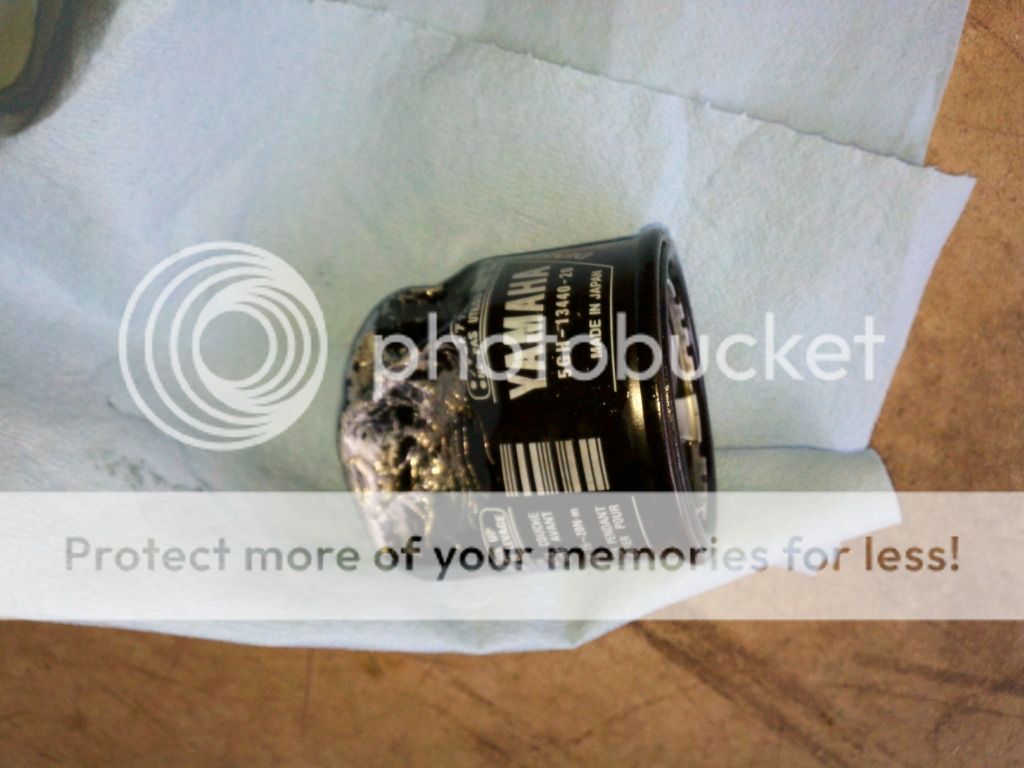

Originally Posted by xzpolskix View Post
Originally Posted by saleenbiker View Post
Use a pair of pipe wrench pliers to take the old filter off. just squeeze it and twist. since you're throwing it away anyways it doesn't matter if it gets damaged.
http://www.ctcsupply.com/images/product-detail/2259.jpg
followed your advice with the pipe wrench pilers
damn man.. yours is totally mangled up hahaha.. mine is not as bad.. but I squeezed same part like you.. interesting!!!
That was off my R1. It's located behind the headers and luckily I was doing it when I was putting in a full system so it was easier access.
