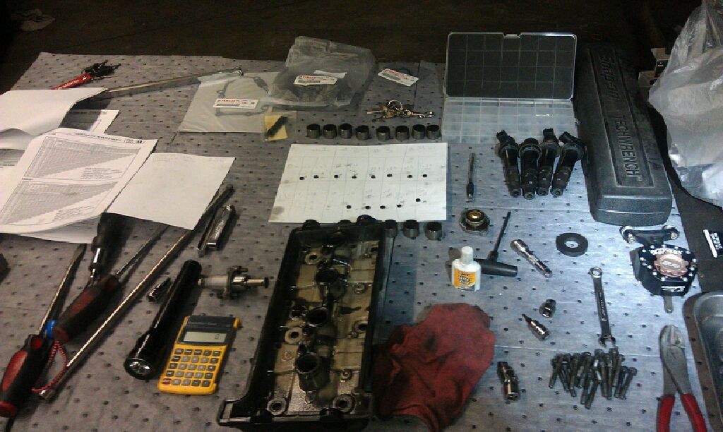

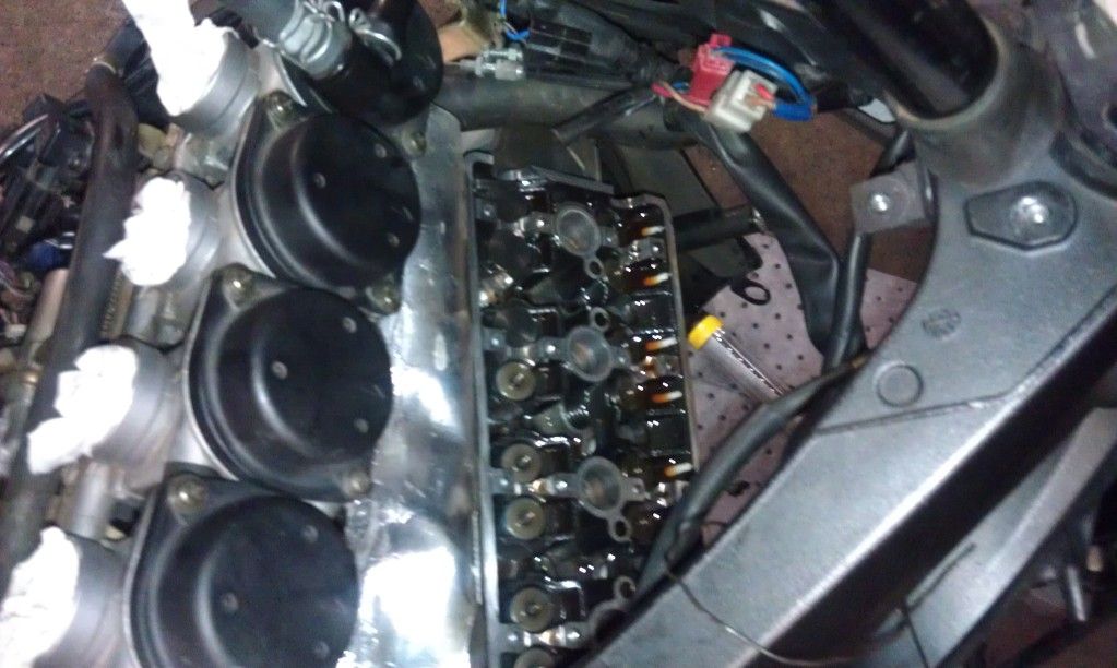

Originally Posted by MorrowDeath View Post
Well the valve adjustment ended up being a success! =) It seemed to be a pretty easy job with no trouble at all, and no extra bolts left over
. Its just very time consuming like how everyone says. It took a good 8 hours of working on her for me to complete the job. I triple checked all my measurements, torques, and took my time with it to make sure everything was T&A. All the valves on the intake side were in spec except one on cylinder #4. For the exhaust side, they were all at the min on the tolerance gap, so I bumped the exhaust valves all up to middle of the tolerance gap. I took her out for a short ride today, she seems to be liking the adjustment a lot. Next ill be doing the throttle body sync, then I can finally get her tuned =) Thanks for all the help guys, heres some pics
