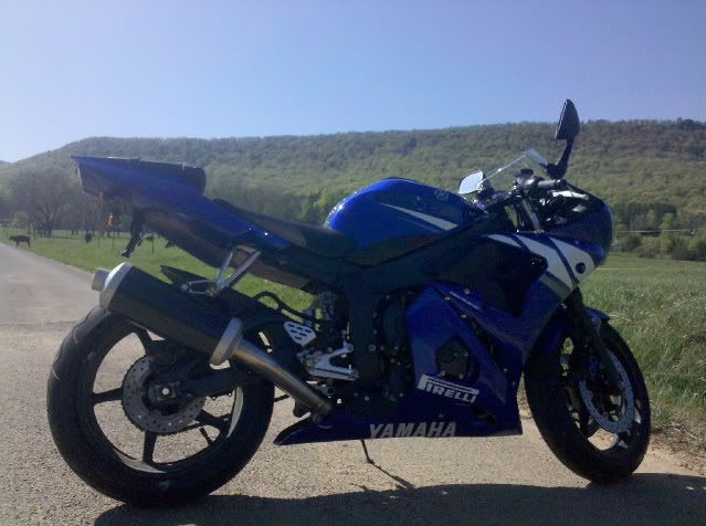

The last thing to be done is to re-attach the end caps. Simply mark and drill the locations for the rivets. Take your time marking and drilling to make sure all the holes line up for the rivets. I couldn't find rivets with the wide heads like the originals, so I just used what fit and it looks fine to me. Finally snap the rivets in, mount it on the bike and youre done!
Riveting
IMO its a thing of beauty and makes a wonderful noise. It cost me less than 20 bucks to make and kicks the crap out of buying an overpriced slip on. The bike definitely sounds more powerful and it returned 42mpg @ 80mph on the interstate, so I know the performance isn't hindered. Its huge upgrade from the nasty look and sound of a stocker and has the added perk of being able to use it as a horn for idiot drivers with the flick of a wrist .
So, if you have the tools (and the odds are most people do), I say go for it!!!
Mounted!
