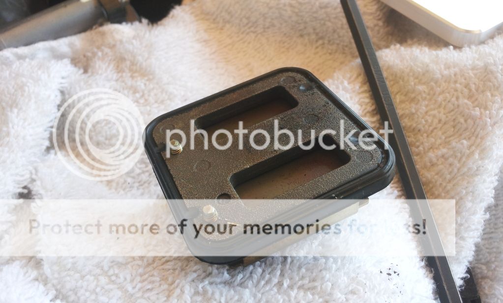

1. Remove the little screws and pop out the the reeds... Like so:
2. Once you remove all the screws and reeds.... This is what you're left with:
Simply drop in it and install the block offs right over them.

5.Remove the bolts holding down the nipples (two per nipple). I did not take a pic of the reeds after removing the nipples...but when you remove the nipples, needle nose pliers make this easier, you will expose the reeds...when you remove the reeds...this is what youre left with...
When you remove the reeds...makie sure you take everything out...here is the complete reed assembly once removed.
Top of reed:
Bottom of reed:
