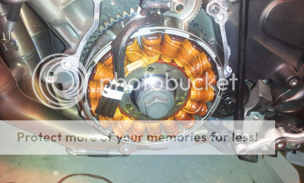

Stator cover / LHS cover Install:

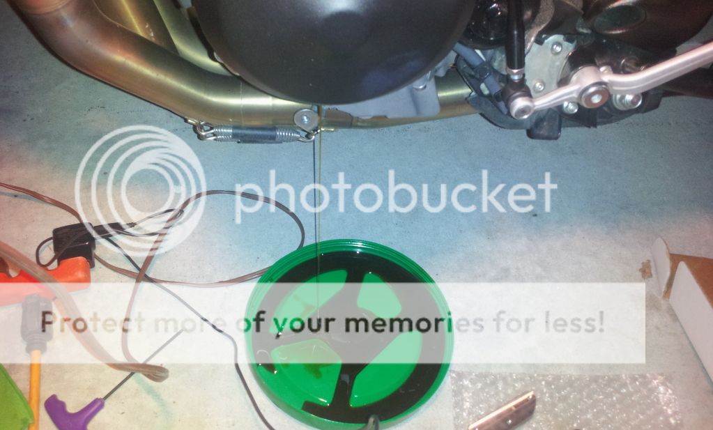

IMPORTANT: USE A CATCH MAT OR CARBOARD TO CATCH ANY DRIPPING OIL. BOTH SIDES WILL DRIP OIL…ESPECIIALLY THE IGNITION COVER…ABOUT 200mL1. Remove all of the retaining bolts.

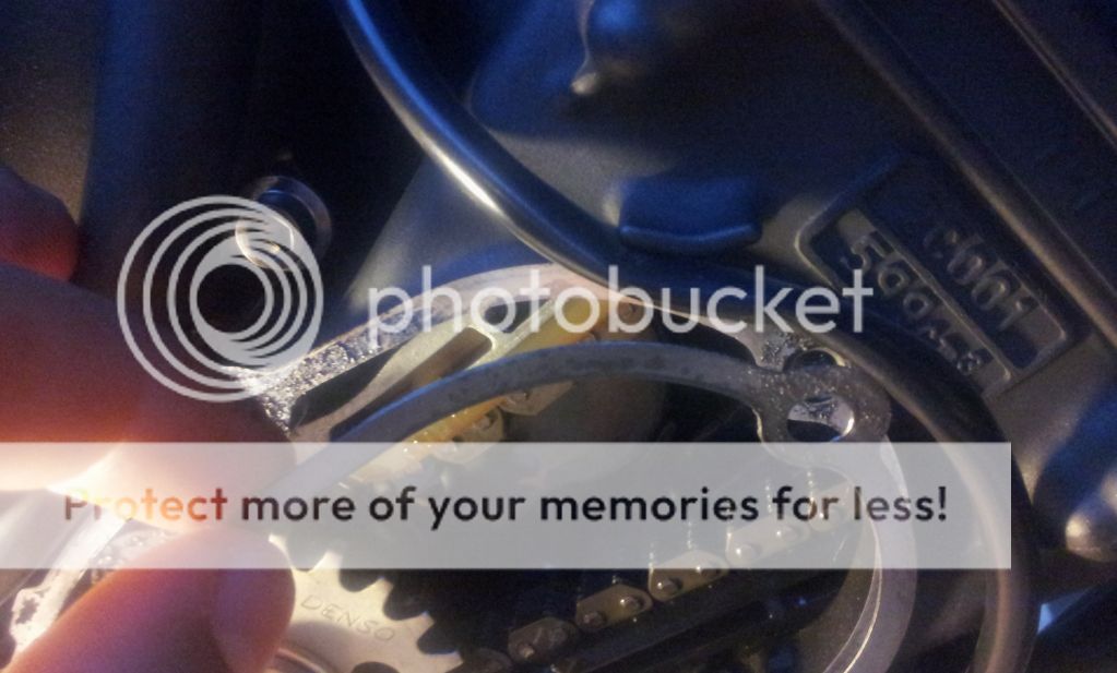

2. Remove the old gasket and using your putty knife…start removing the residue left from the old gasket.
Make sure you completely remove all of the residue….Then using your brake cleaner…spray some cleaner unto a microfiber towel and wipe the mating surfaces clean.

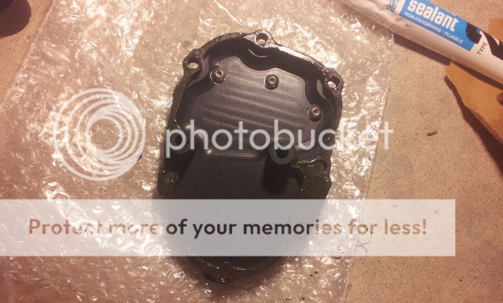

4. Once the mating surface is clean…using your silicone gasket sealant….and finger…apply some small, but sufficient, amount of silicone along the mating surface of the case.
5. After applying the silicone sealant to the case…install the NEW gasket over the silicone.
6. Next, apply some silicone sealant to the mating surface of the cover
7. Before proceeding …makes sure there aren’t any huge pieces of silicone trying to make its way inside the case. Next, line up the cover so that it slides into the guides inside the case...next, apply a dab of RED LOCTITE on each retaining bolt and hand tighten them. DON’T FORGET TO PLACE THE BRACKET HOLDING THE CLUTCH CABLE BACK IN PLACE…don’t ask me how I know. After all of the bolts are hand tighten…start tightening the bolts in a criss-cross method….don’t hunk them down all the way at once…slowly work your way around until all of them are snug. Refer to your service manual for torque values if you anal.

IMPORTANT: MAKE SURE YOU HAVE SOMETHING TO CATCH THE DRIPPING OIL…THIS SIDE WILL LOSE SOME OIL SO BE READY!

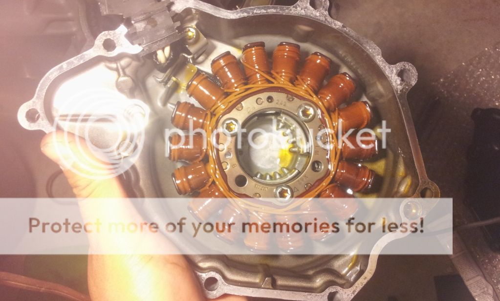

2. Once you have pulled the cover off…it will remain attached because the ignition coil is bolted down by three torx bolts….take your handy torX bit and loosen/remove the three torx bols…also, you will need to remove one more torx bolt that is holding down the bracket for the wires…so you will be removing a total of FOUR torx bolts…KEEP THESE.
3. Once you have detached the ignition coil and the bracket….DO NOT SET THE IGNITION COIL BACK INTO THE CASE….ITS MAGNETIC…VERY MAGNETIC..DONT DO THIS:

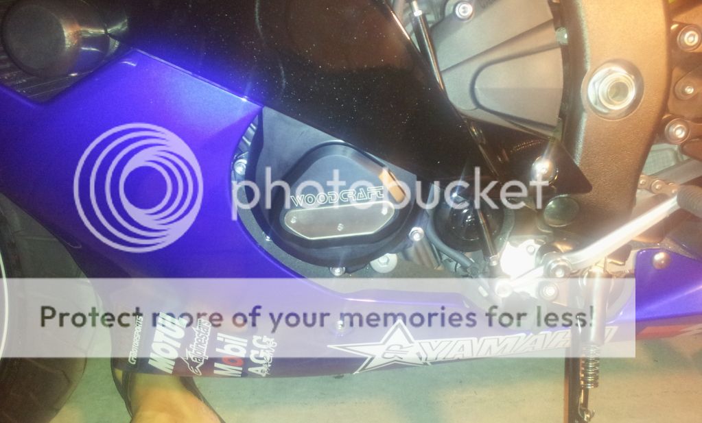

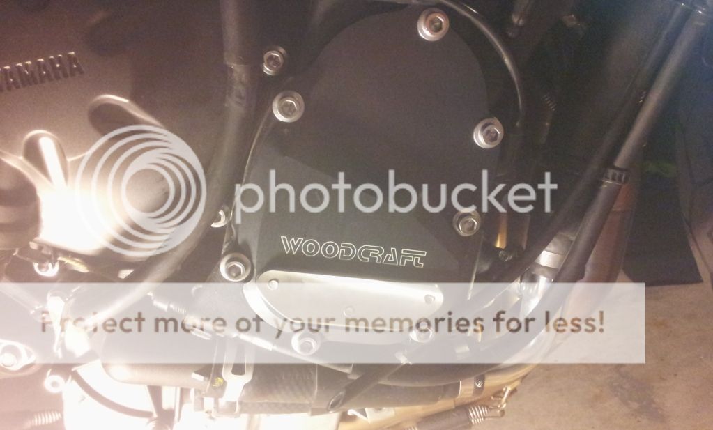

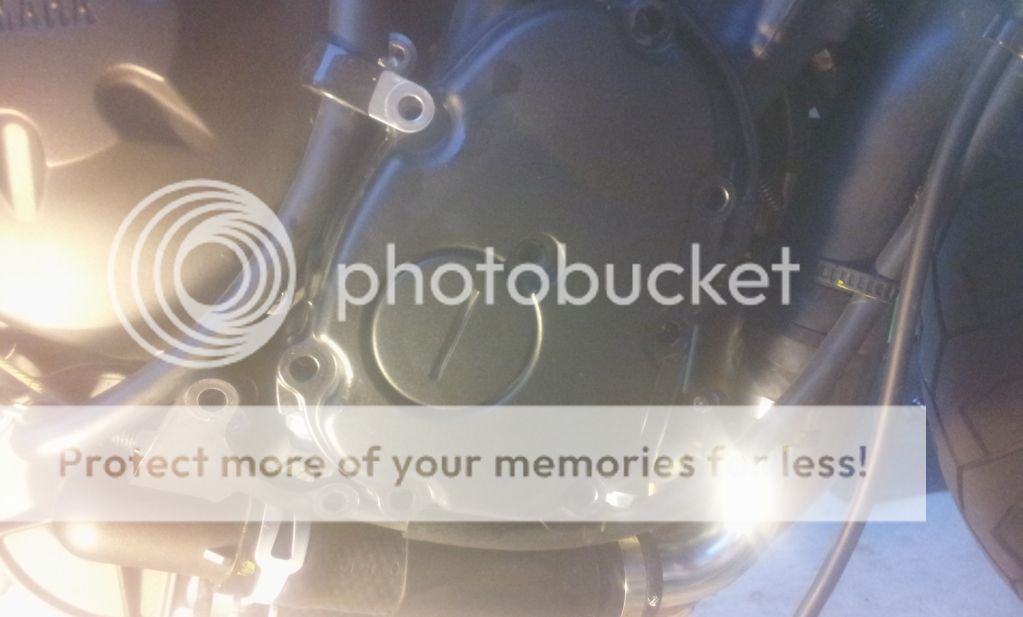

Finished product:
Stator side
Ignition side

fyi... a little trick i learned on getting those torx bolts out without stripping them - take your time with a pen-torch heating them up BEFORE you get to cranking on em (that hold the stator in). i use this:
Butane torch like that from radio shack or a heat gun is a good idea as well. Those torx are much easier to remove after heating them up!
