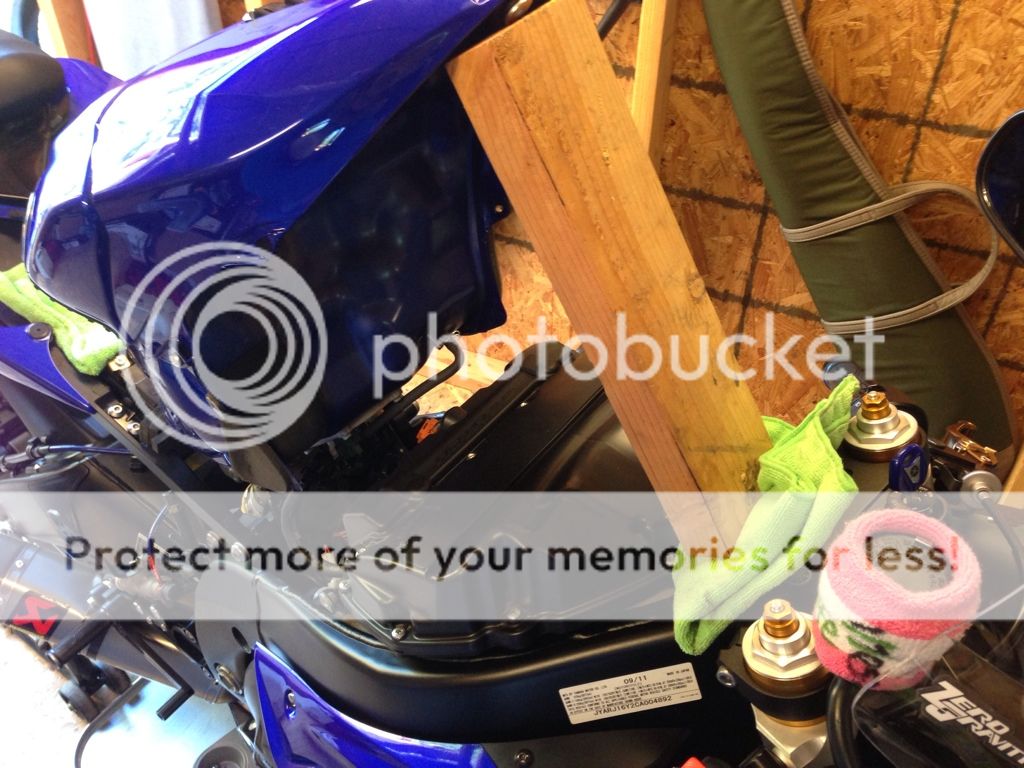

5. Life the tank from the front. Place a towel between the air box and the triple tree and place your stilt. I use a 2x4 which works great.
My stilt lol.

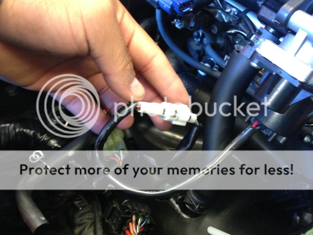

6. Once the tank is propped open. You will remove one two vent hoses, two electrical plugs and once fuel line.
Remove the first vent hose using the needle nose pliers
If you have the charcoal canister, you'll have a vent hose connected here as well
Remove the electrical plugs

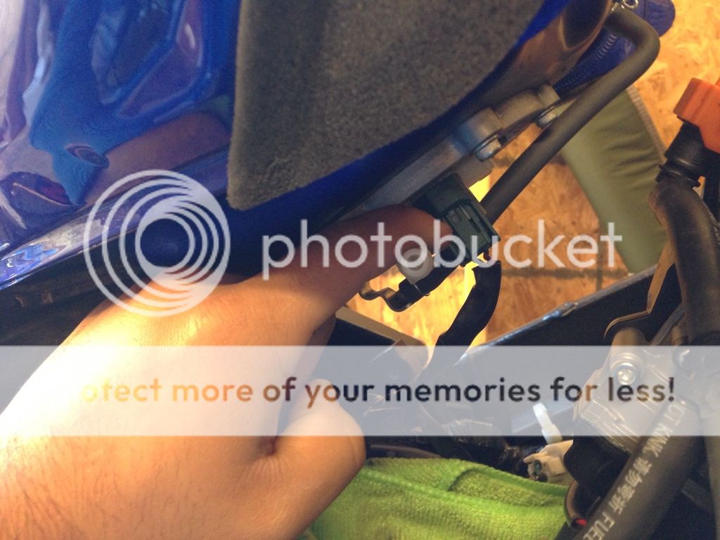

Remove the fuel hose. There will be gas in the line so have a towel hand. Remove the plastic clip first
Squeeze the blue buttons on both sides... Twist and pull and you hold them. They are a bit tough so be careful and make sure the tank doesn't come done
Everything disconnected from the tank

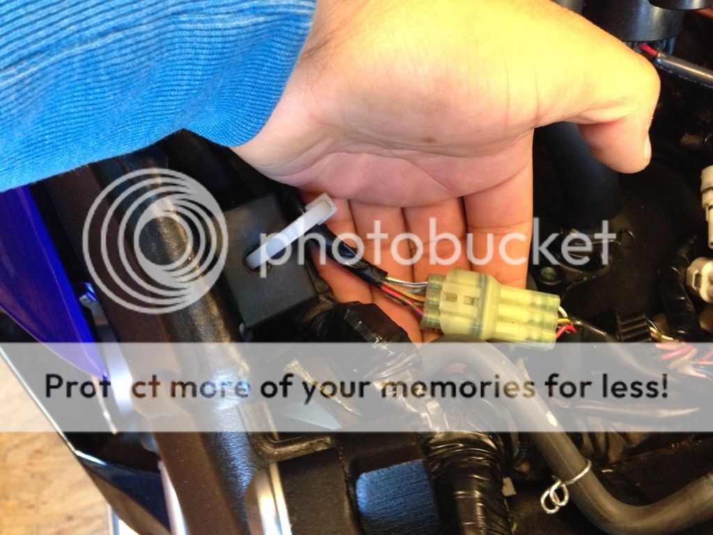

9. Disconnect the electrical plugs coming from the upper injectors and the plug coming from the lower part of the air box
LOWER
UPPER
You'll need to loosen the zip tie from the frame to feed the upper plug through it. DO NOT CUT THE ZIP TIE. You simply pull on the little tab and the zip tie will loosen.

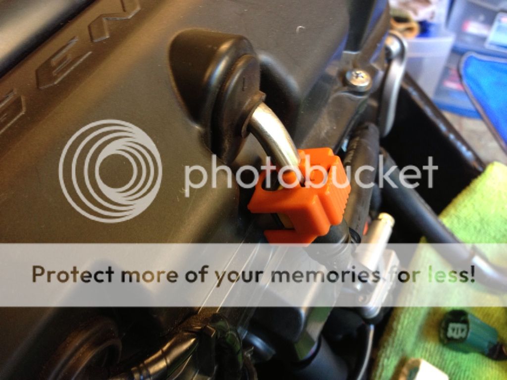

10. Disconnect the fuel hose from the upper injectors. It will contain fuel so have a towel ready, or a container.
Locked
Pull the orange clip out to unlock it, once this is done, squeeze the yellow buttons and as you do, pull and twist to remove
Zip tie the fuel hoses like so to keep them from draining fuel

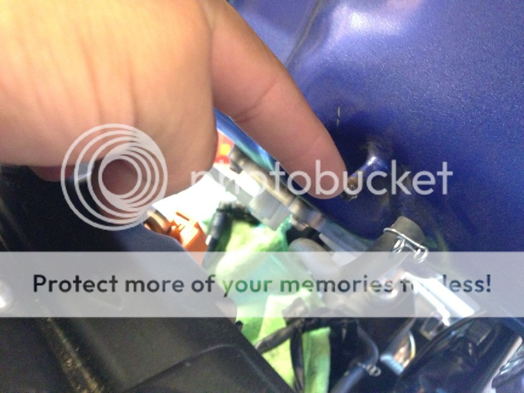

11. Disconnect the hose from the bottom of the air box using your pliers

If you choose to follow agg's suggestion about tilting the tank back.. This is what you do. My tank was fairly full of fuel so I used the 2x4 to help a little.
