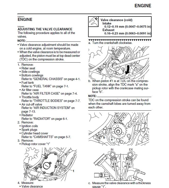

if the valves were getting tight, it would have been getting steadily worse the last few times you have ridden it. The fact you indicate the bike sits for extended periods of time points more to a fuel issue.. as in bad fuel. Google "ethanol, fuel injectors".. ethanol is bad stuff. You are north of the border, so if you have ethanol in your gas, and the gas has been in the tank a good while (more than 3-4 months) get it out and try a fresh tank.
When you DO store the bike, store with a full tank and use your favorite fuel stabilizer as directed. A not full tank will form condensation, and that water does not mix. it settles to the bottom as the fuel breaks down, unlike fuel from a few years ago that had mtbe as a octane booster. It mixed with a small amount of water much better and you could get away with a machine sitting for up to a year sometimes without issue. You are running seafoam now, but that won't help fuel that has already phase separated (that is what occurs with e10 fuel or any fuel with a % of ethanol).
this may not be your problem, but is worth a try along with the other suggestions. At 29,000 it's at least time to check the valve clearances. that is an easy job to be honest. adjusting them is more difficult.
Also run your diagnostic mode and check throttle positions. you will need a manual to check the specs for each value that reads out on the dash in daig mode.

Thanks very much, that thread helped for the actual cleaning, but the 06 TPS is in a complete different location. I downloaded the Service Manual and have a breakdown of where to find the TPS on the 06 (FYI, its kind of a bitch to get at compared to the 03-05).
I am assuming I need to clean the TPS for the throttle valves and the TPS for the throttle cable pulley. Will keep you posted on how things progress, I'm going to tackle it when I get home from work tonight.
Thanks very much. The longest the bike has sat is about 4 weeks and even then, I ensure its full; however, I didn't have stabilizer in it, but I think I will drain the tank as you described above anyway, at least then I can potentially eliminate fuel as the issue.
I have read the in-depth how-to on checking Valve clearances, but I think when I get to that stage (after checking and cleaning the TPS) I will let the shop do that for me (we get military discount at my local shop, which helps).
The numbers for the TPS according to the service manual are 12-21 and 97-106, so I will try the diag mode first and write my numbers down, then clean the sensors and see if it changes anything, but from everything I am reading and getting frmo people, it sounds more and more like the valves need adjusting. At least I have a heated garage and beer fridge and I am getting to know my bike intimately.
