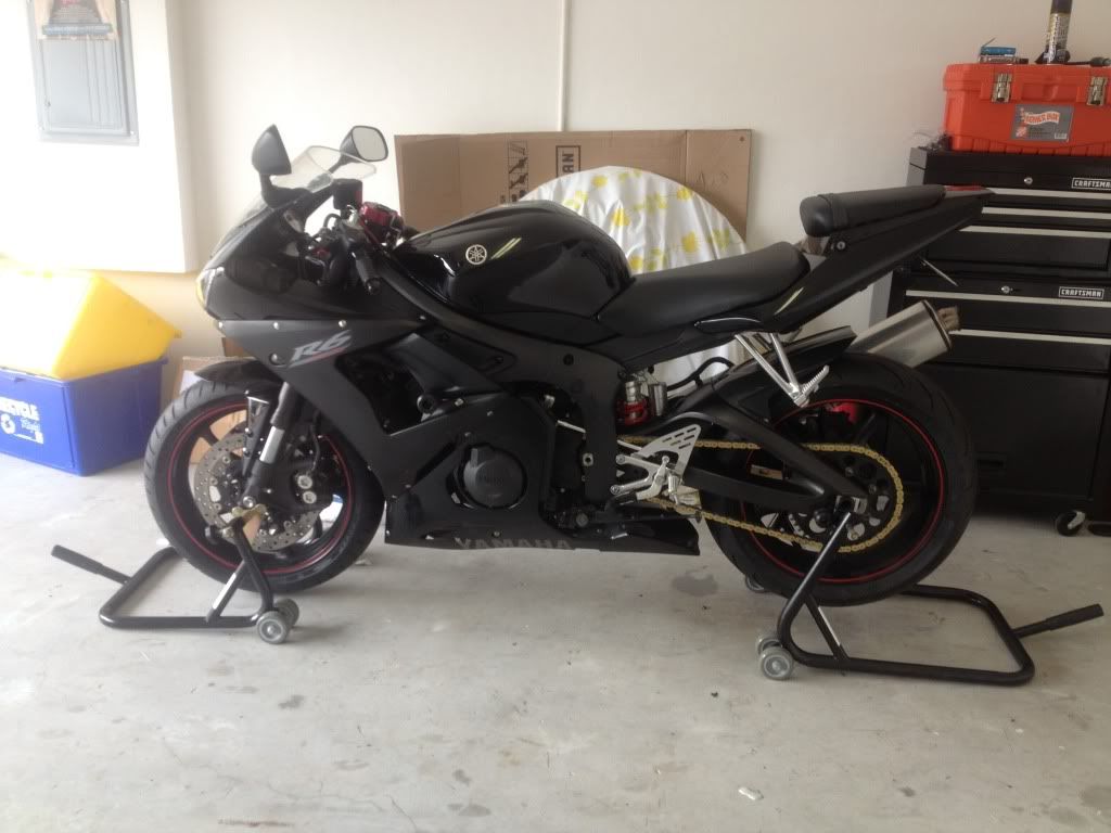

Thread is going to be a mini-build thread. By mini I mean I'm only going to be upgrading bolt on style modifications:
2005 Yamaha R6 Raven Edition
65XX Miles
Mint Condition - Never dropped, raced, no scratches dents.
Purchased 11/16/2010 Price $4300.00
Current upgrades: Micron Full Exhaust
Purchased Upgrades: OES (no cut) Frame Slider - $49.00
OES Clutch Slider and Spools - $15.00
Motodynamics Smoked Integrated Taillight - $60.90
Ebay Smoked Flush Turns - $19.00
CustomLed's Relay Kit - $24.57
Ebay Fender Eliminator - $25.25
ASV Levers - $213.00
GPR V4 - $350.00
ZeroG Dark Smoke Double Bubble Windscreen $76.00
Driven Evo-Spec 520 Conversion Sprocket (BLACK) $210.00
EK ZZZ GOLD 520 Chain $Package deal w/ above
Driven Red Sprocket Nuts $24.00
Pilot PURE Front and Rear Tires $280.00
Running Total So far 1345.82
Future Upgrades:
ASV Levers (DONE! 02/16/2011)
Grips (D3?) (DONE 02/18/2011)
ZG DB Dark Smoked Wind Screen (Ordered!)
Tank Pad (DONE!)
Black Bolts (TBA)
Powdercoat Rearsets / Pegs (TBA)
Black/Red Gas Cap (Evotech????)
Woodcraft casings
rear sets (GP Shift)
Bazzaz
Quickshifter
How she sits now:
