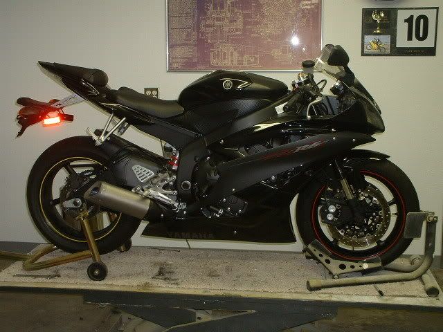

Lets get to work! Here is the bike as it arrived, 873 easy street miles on it, from the looks of the chicken strips they were very easy miles. ;) The front tire still had the painted stripe down it's tread. I put about 20 street miles on it to get to-and-from the DMV before stripping it down. FYI, the DMV gets very cranky when you bring a bare frame down to title it, so make sure that gets done up front! (how do I know that?!?).
After the DMV circus we slapped on some Michelin DOT race take offs on the rims and my tuner Zoran from Twinworks Factory took the bike down to a trackday at Willow Springs just to see how it would do all stock. Of course I was a little irritated that I was sitting at work while Z was wringing the R6's neck, but gotta' pay the bills, ya know. I called him at noon to see if he had thrown the bike down the road yet and he said 'No, this thing is facking great man, you might had to buy another one 'cause I might just keep this one'. 'Cool' I though, if it is decent stock we might just have a chance...
