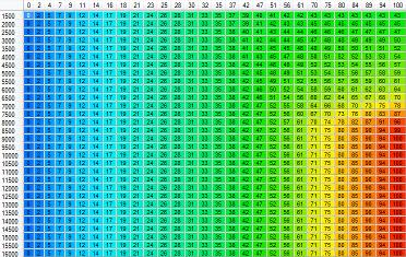

Ok so I've had some time messing around with my Flash-Tune flash interface. I've decided to start this thread to openly discuss some of the pros and cons, recommendations, and thoughts on the interface. I will eventually add this into my FAQ when I'm done (In a much revised manner).
Lets first go over some of the restrictions, and maps that are currently on the R6. All the maps I'm posting are for the 06-07 models, as I have an 07. The 08+ are actually quite a bit more restrictive though. (06-07 and 08-12 TPS maps compared here.)
This is the stock throttle map:
Full Resolution Image
This is the "race" throttle map, that is included with the software (Should be similar to the YEC). You can edit this map to be any values you want:
The changes to the map seem mild, but it actually makes a noticeable difference. I was actually surprised to see the 06-07 R6 had a much less restrictive throttle map from the factory than the R1s and the 08+ R6.
