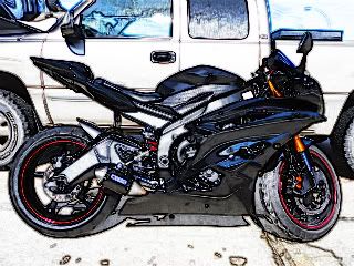

I'm thinking of changing the rad cap (stock is 1.1 bar) to an aftermarket high pressure rad cap (2.0 bar).
My goal is to try and reduce my bikes coolant temp now I know increasing the cooling system pressure will increase the boiling point of the coolant but will it actually make my bike run cooler?
Graves and CV4 are 2 reputable brands with rad caps I found.
Has anyone done this mod?
Also what is the difference in temp I can expect?
