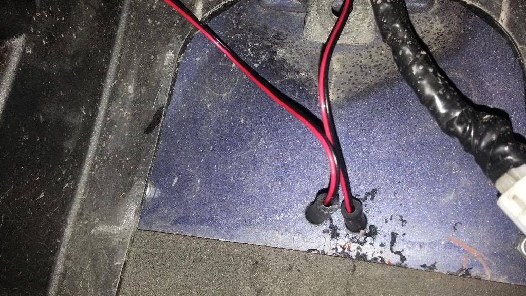

Using the 5/64 drill bit, drill two holes between the mounting bracket behind the licence plate.
I used a small drill bit to drill a small length inside the heat resistant tube so it can be screwed onto the licence plate screws.
The heat resistant tube will slip over the wires to make them look better and keep them from getting damage. I also used WD-40 to help slip the wires easily.

The wiring part is very simple, I used extra wire and taped it up for extra security and to release tension (if any was ever to occur)
