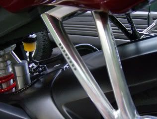

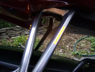

I had the bike apart the past week and half to up grade all the lights. Heres what i did. 8000k HID lights, led passenger pegs from tripageled with 8 amber leds rear facing and 8 amber leds side facing for blinkers (clear alternatives/protons already installed), and two amber Leds installed for tag light.

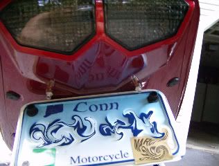

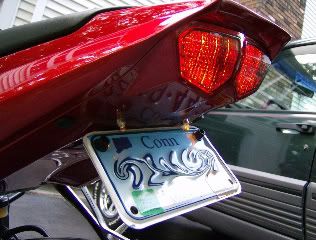

the leds installed for the tag light are fed off the stock 12.1v harness for the original. i went to radio shack and bought a 1/4w 220 ohm resistor and 2 2.1v leds and wired them in parallel. one seems brighter than the other though, if i have sometime ill play around with that.
