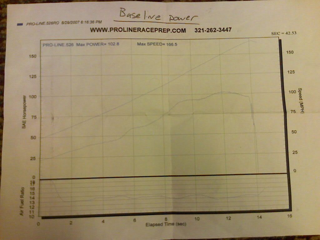

Here is the stock dyno chart.
That says 102.8 HP and a top speed of 166.5 MPH

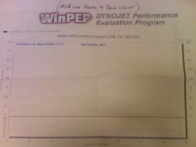

Here is the new one...only things added were the MJS race header and the Termi slip on...and a PCIII of course :toocool:
That says 111.2 HP and a top speed of 169.4 MPH
I am running a European R6 Termi full system map at the moment... after I get a new filter and some block off plates I will have it custom tuned. :YEA

Nice, I love the header. I plan on getting the same slip on with mine.
322 Posts
wow its running richer past 8k.. those who tune, does this mean that there is still some more power in it?
My R6 ate my homework
550 Posts
free dyno sessions so I guess you can't complain...they don't tune it for you unless you pay and I am not ready for a custom map yet. I did it just to see what kind of gains I was looking at and to help a little on the A/F ratio so I can tune it a little more. I teaked the bike a little more since then on the higher rpms snd she seems to run a lot better now.
I just need to pick up my last couple of power adders and then the custom map will come.
