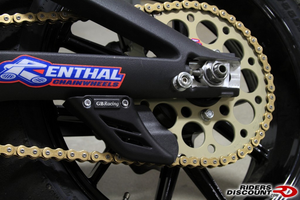

We installed a GB toe guard on our Daytona 675 project bike. Notice how the fin on the aft side lays very close to the chainwheel to provide the best protection possible.
