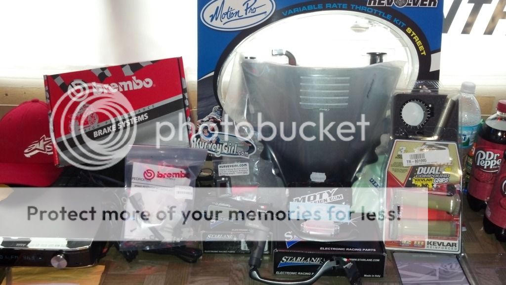

First round of mods in 2012....
MotyDesign 4 cell battery
Puig light smoke windscreen
Brembo RCS19
Brembo fluid reservoir
Brembo clutch lever
Motion Pro throttle kit
Renthal clip-ons
Renthal grips
Starlane Engear gear indicator
Starlane gps-3x lap timer
Optimal Racing fairing kit
KurveyGirl Dzus fastners
MJS full system exhaust
Bohemian Racing rearsets

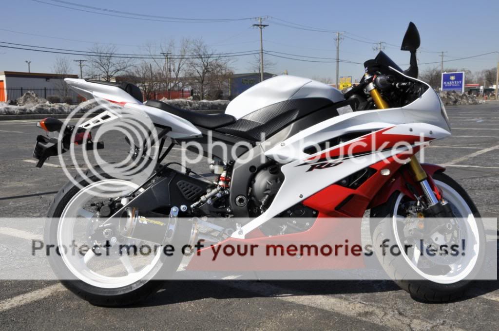

After installing all the goodies, bike went to the first trackday looking like this

2nd trackday I got the plastics coated with PlastiDip. Nothing special just trying to add some color
Then came the first get off. Luckily just some damaged plastics and a broken right clip on.
Took off all the color, fixed the plastics and resprayed it to look like this (also added on an Ohlins steering damper).
That was what it looked like at the end of the 2012 season. 2013 has MANY changes coming.
