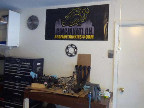

So after seeing how dry the swing arm bearings, and suspension link bearings were on my DRZ, figured I better do the R6 as well.
So start by removing the radiator... seriously. Got to love sport bikes, where even a simple oil change requires removing a bunch of stuff. Even the gas tank had to be removed.
I had hoped the pivot bolt for the swing arm would just unscrew without removing the castle nut, however it did not, so I was forced to sacrifice a socket to make a special tool to remove it.
Got a pile of parts on the work bench now, to be cleaned, re-greased, etc. The bike will be apart for at least a week, as I'm sending the shock off to be serviced, and re-sprung for my weight.

Wait, so why did the radiator have to come off? Are you doing plugs or something too?
Had to take the header out. You can get the header off without completing removing the radiator, but you can properly torque the bolts when re-installing with the radiator in the way.
