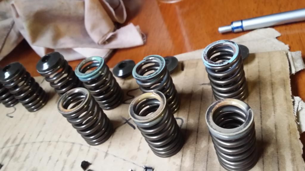

So im doing my top end on my 08 r6 I striped it down and left everything in order and neatly put aside.
I began reading YEC manuals and noticed the yec intake springs are light blue and the exhaust springs are yellow
my springs are organized opposite to that stated above
Now as far as I know my springs are stock..... what colors are what stock?
Thanks

I don't remember mine being any color. Just black

Ahh I just pulled my buckets off and seen them that way. I'll check my manual in a sec and get back to you

When I shimmed my valves.
Manual doesn't say anything about color either. Hmmm you may have yec springs

those are oem springs, i just don't remember which color is what. Those are OEM springs though. i recently had 2 engines rebuilt.. will have to get with my guy on which color is in/exst. It can vary from 06-07, 08+ and even later, there were updates. (purple spring paint i think for one side). There is a difference.
If you are reusing them, ya need to measure free length. And make sure there isn't wear on the retainers (those round things that hold the spring down).

thanks heaps mate, ill try to find an engine builder around here that might know
