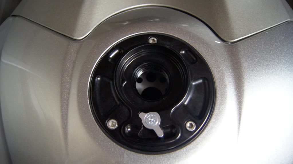

The Vortex V3 gas cap installed...
Gas cap locked...
Gas cap unlocked...
Cap unscrewed...
I now, see why this item is selling like hot cakes! :secret Another excellent product made by Vortex! No wonder, why AMA teams uses Vortex products! Can't really compare the V3 to other gas caps though, first aftermarket cap for me! Install was easy! Took about 30 minutes! Hardest part was cutting the stock gasket to fit the V3 cap! Very happy with the cap! Great design! Very lightweight! Can't say enough! A+
