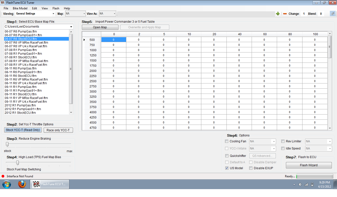

Ok well I got my interface apparently on Saturday, unfortunately I didn't check my mail box, so I just now got to check things out.
First impressions, are a little shakey, however I haven't flashed anything yet, so these are strictly first impressions. The device comes with no software what so ever, in the bag was a letter that says to download the software from their site. Worse yet you can't download an off line version that I can find, you don't load a 400 kb file and then the setup file downloads another 22 MB. Not sure what you would do if this company goes under? I understand they do it because they constantly updating, but I would prefer to have a copy of my own, just in case. Second that letter that gives you the URL to download the software is the only piece of documentation what so ever you get. There's not even any help files in the program, it takes you to their web site, which sadly is also equally as useless, with no "real" documentation what so ever. If the pages said something more meaningful, like high load fuel map, low load fuel map, ram air correction, etc, but they aren't, which isn't very useful.
I'm sure many of you have read my posts, and can probably guess I don't like modifying things until I have a reasonable understanding of what is going on, and how it works. I'm not impressed with the complete lack of any documentation or help in any manner with this device. I believe for the most part they market this device to be a "replacement" for a PowerCommander or other piggy back system, that also does timing, and throttle map changes. This also has the ability to work with a quick shifter as well. This does allow you to import PowerCommander maps as well, and I think that is primarily what they expect you do with it. However this has more possibility than that, and I believe to really unlock the full potentional it's going to need further tweaking beyond just importing a power commander map.
Ok so admittly even with all the bad documentation, I haven't flashed my ECM yet, and have read tons of good reviews, so I will withhold my final judgement until I've used it. This is only meant to be first impressions. I will post up again after I have flashed my ECM with some intial feedback, and then again after a few weeks of riding.

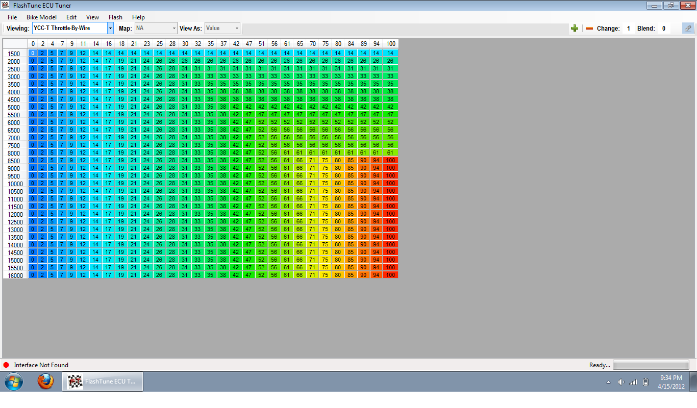

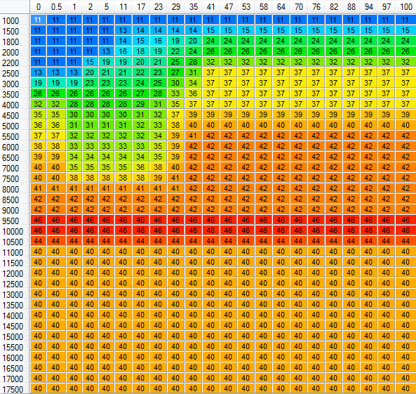

This is the main screen, I have a feeling this is the only screen they want you to use. You select a map, by default they include a Stock map, pump gas, 91+ pump gas, and two different race fuel maps. The changes between these maps are very minor, leading me to believe they definitely have chosen to err ont he side of saftey, which is good.
Full Resolution Image

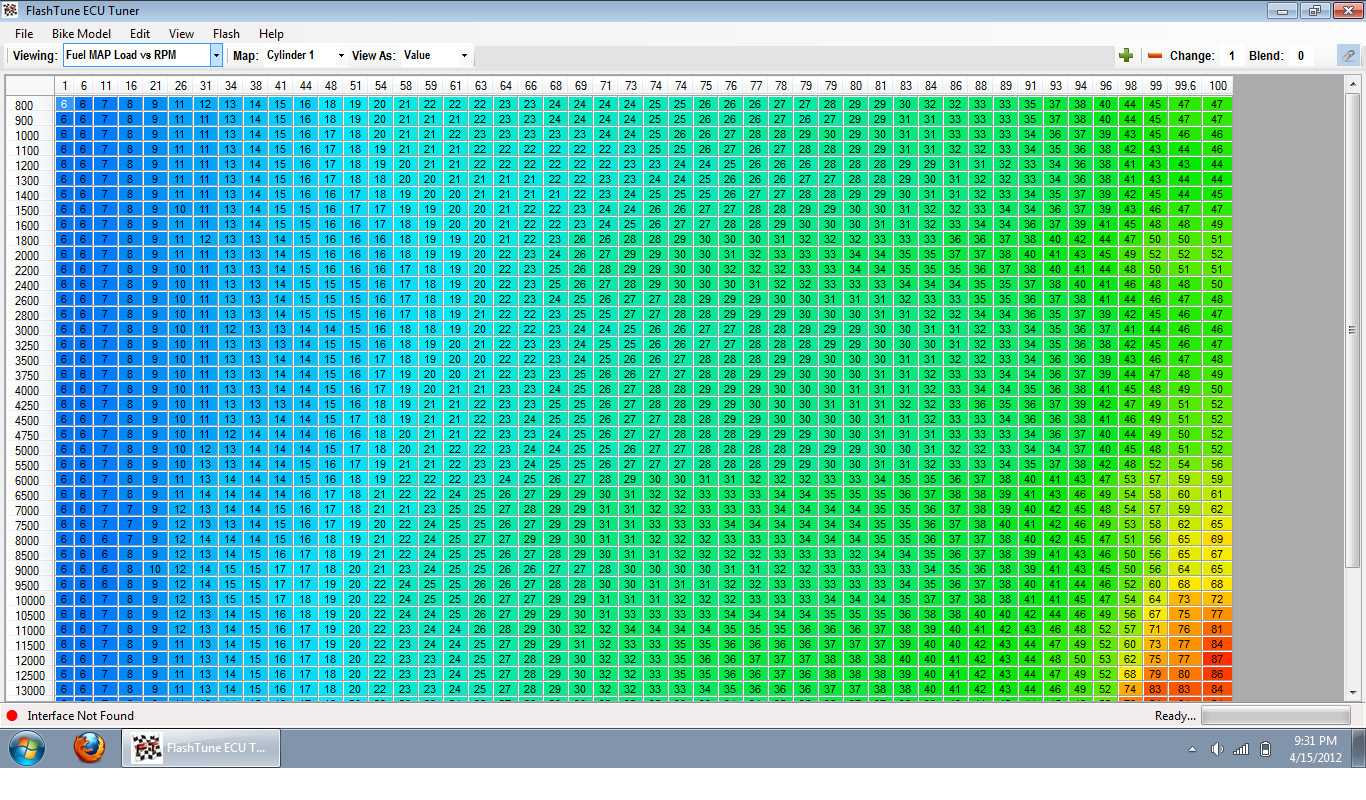

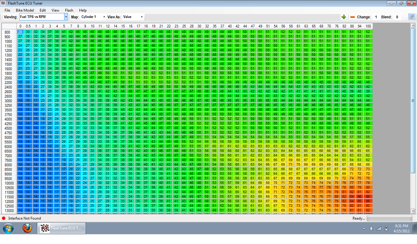

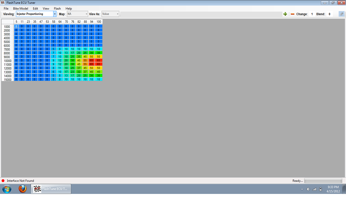

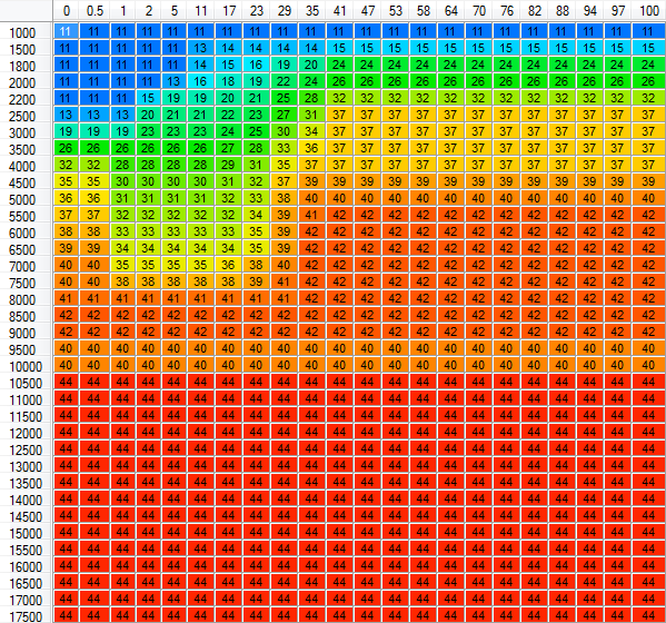

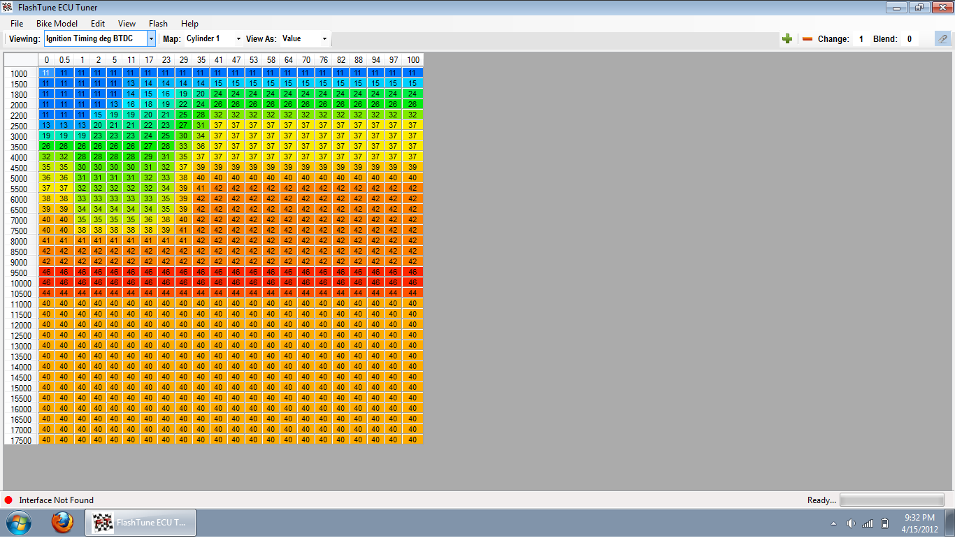

These are the "advanced" tables. You can edit these as well, similar to editting PCV or Bazzaz maps, and also includes a "blend" feature.
